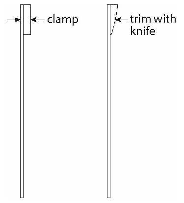

In the last guitar I made I used reversed kerfed lining. I doubt I will use
them again. If it breaks anywhere, or you need to start a new piece, you
can see the joint between the separate pieces. The seam between pieces
of conventionally kerfed lining don't show, as it is against the side. I also
think reversed kerf lining adds a lot of unnecessary mass. I use
continuous linings on the back seam of classicals, but steel string guitars
need slightly wider linings that don't bend well, so kerfed linings are all I
use there. I have a simple indexing jig for my band saw to make the kerfs.
I glue in the linings having a rectangular cross-section. That makes it
easy to get uniform clamping pressure. Once glued, I use a knife to cut
the taper, leaving a slight curve rather than flat.
